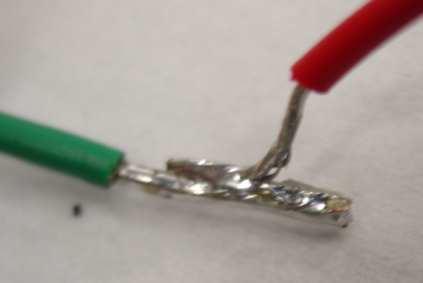

Don't solder wires without twisting them together. As shown in the pictures below, they pull apart very easy and will not hold up over time.
